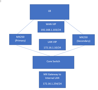

Team, we have a migration tomorrow for MX250 HA setup and testing HA failover. WAN failover works and when primary fails (power down), secondary takes over seamlessly. However, when we unplug downlink of active unit to downstream switch, both MX becomes active/active. Both MX are not directly connected and LAN failover I assume to work via VRRP towards downstream switch using its virtual IP. Please advice what i am doing wrong here. I followed few guides as below but i need someone to correct me if i am doing something wrong here.

That is expected behaviour
Use recommended setup with more downlinks https://documentation.meraki.com/MX/Deployment_Guides/MX_Warm_Spare_-_High_Availability_Pair#Recomme...

@kishen32 As you only have one downlink from each MX250 to the core switch if you unplug a downlink then the VRRP messages between the MX devices will cease to flow. Since each MX is no longer receiving VRRP messages from the other each will assume the other has failed as will try to become master (or remain as master). Remember that the WAN interfaces aren't used for VRRP messages.
Looks like the only document you haven't listed is this one, https://documentation.meraki.com/MX/Networks_and_Routing/Routed_HA_Failover_Behavior.
