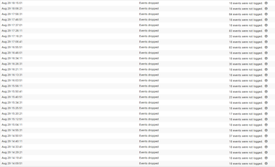

Hi, first time using MX and so far the experience is very good. Right now we're using MX67 as our gateway, a few days ago we experience network outage several times during live conference and trying to find out why the outage occured. I've checked on the ISP NMS and can confirm their network doesn't have problem.
Some question here :
  1. how does meraki treat client size limit (MX67 is recommended to use for network 50 clients and below - but we're pushing this by using it on network with 100 clients as our uplink only 2x20Mbps).
  2. Every time the network outage occurred we notice on Meraki log there's several "Events dropped" log, does this mean our MX is overload (still the bandwidth utilization is low - about 15Mbps only and the uplink monitoring on meraki to 8.8.8.8 is working fine) ?
  3. On summary report, at the time network outage occurred the MX CPU utilization is very low - 10-40% only
I suspect this happened because Meraki have packet overload from 100 clients, but still confused why the utilization is low.

Hi, the utilization is low, but we got a lot of event dropped on the event log

Opening ticket to the support and they confirm the cause of network down is because MX overload, the event dropped log is because of spike of traffic that not getting logged on MX utilization. Maybe its time to look for bigger firewall.
