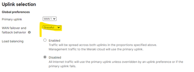

Hi @Crocker - what version of firmware are you running?  Sounds like a bug to me.  Have you trawled through your other SD-WAN & Traffic shaping settings to ensure you have nothing erroneous configured?
I would assume you have your Primary uplink set as WAN1.  For giggles have you tried flicking WAN failover and fallback from Graceful to Immediate?

We're running 16.16.8 across the board, due to some unrelated issues regarding MX17/18's IPv6 support and some carrier modems with really low IPv6 DHCPv6.
Unfortunately, that also means we don't have the option to select between graceful/immediate for WAN failover/fallback. I'm unsure what the 'default' is, in MX16.
