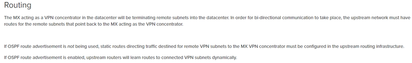

@DerikA Check out for OSPF routing in the link below
https://documentation.meraki.com/MX/Deployment_Guides/VPN_Concentrator_Deployment_Guide
