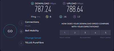

Jesus... What happened in that version !!
I'm hitting +100Mbps in download versus MX18.106 and older.
Is it time for to call my ISP and upgrade to 1Gbps?

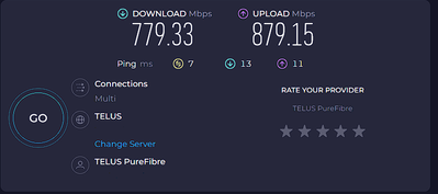

RaphaelL
Well after I upgraded my home link to 1G/1G , I'm hitting even higher upload with this firmware :
LeoTran
