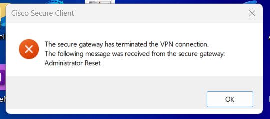

Dear friends,
We're using AnyConnect and MX100 and facing an issue: that every 30 minutes in Event log show that Anyconnect Server is shutting down, then 1 second later Anyconnect Server it start. Althought we have clients and also modify in sessions time-out is None, it still happen. At that moment in client disconnected and show alarms that Secure Gateway has disconnected. and Administrator reset.
My MX100 is using firmware version 18.106
Is there any one that has same problems too?
Thanks a lot if any suggestions.

I'd be tempted to try the current Stable MX firmware on this (17.10.5, I think) - but raise a case with Meraki Support, if you haven't done so already.   If it works on 17, it's still worthwhile raising a case for the issue on 18, to the benefit of many MX customers - though Support might request you leave it on 18 for a period of time, to do some more testing & gather related information.

Thanks Mr. Green, I scheduled to rollback firmware to 17.10.2 first (then after that can move to 17.10.5).

Dear friend, we rollback to firmware version 17.10.5 and it works well. Thanks Mr GreenMan for your help.
