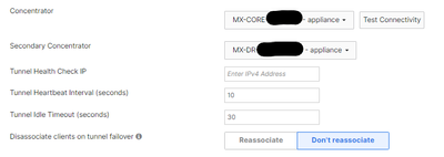

We have a similar setup, two pairs of MX450s in different DCs. It is possible to setup 'secondary concentrators' for tunnelling SSIDs, screenshot below:
We split the connections to different HA pairs of MX450s to spread the load, but have secondary concentrators setup in case of DC failure.
