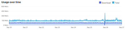

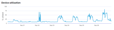

Hi ,
We are currently upgrading from MX 18.107 to MX 18.211.3. Upgrade date is sept 26th and devices are MX68CW.
After upgrading 500 networks I noticed a general trend. Device utilization is going up in 80% of our networks.
Some are more obvious :
Anyone else encountered this ? I was expecting a better device utilization not worse 😐

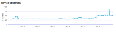

Little update : This increase of device utilization seems to be caused by the IDS/IPS module. We are running in IDS Security mode.
More to come.

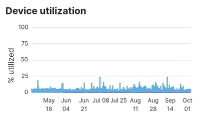

I upgraded an MX75 running the IDS in security mode from 18.1xx to 19.1 in June and as you can see below the usage didn't really change:
Though looking at it again it might have increased very slightly... I do however remember the increase with 18.2xx being quite marked.

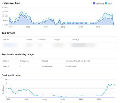

Even a MX85 is struggling since we upgraded it this week :
Support has suggested to go to MX 19.1.4 since some fixes are present in that version that are not yet ported to MX18.2 . Not a fan of running beta firmware while 'stable' firmware is not even stable but I will give it a try.

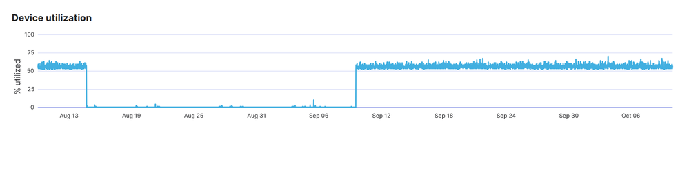

Yes. I confirm an HA pair MX105 is struggling to stay below 50% and it is hardly doing anything

about one month ago.

So you had already problems prior to your upgrade... looking at the utilization around aug 13th

before that they recommended a reboot and I did it. The problem was solved. The after that I opened a case and they said this:
I apologize for the issues you've been experiencing with the high utilization of your MX.
After investigating, I found that there is a known backend issue causing high CPU utilization following the upgrade to firmware version 18.211.3. As a workaround, we would need to disable the backend feature internally on your MX and downgrade it to version 18.211.2, which is the current stable release.
I recommend reaching out to our support team at your convenience by calling +1 415-937-6671. We’re available 24/7, and any engineer will be able to assist you with this issue.
I never called them. The whole backend issues sound fishy to me

Would be curious to know what backend feature they are refering to.

It is an option. But I want to get to the bottom of that story before downgrading since Meraki doesn't seem to know at all what is causing that.

I called them again but they still don't know the trigger. The workaround is the downgrade. They referred as well once again to the backend feature. Really odd! Meraki support is good when you need their assistance with basic things: configs, licenses, packet captures and so on. When the issues are bugs you can never get a clear explanation.

We saw the issue with MX 85 / 95 units on 18.107.2. MX's running 95% utilization or better! 18.107.3 seemed to correct the issue.
Learned to look at this python script / API call after upgrades after that!
