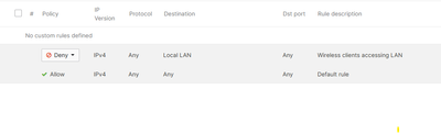

@Brash looks like this policy in the MR (I believe it's there already because I can't recall I set it) probably causing my issues:
I will try to remove or allow it later today to test it out. Thanks.
Yes, that's probably the problem, set it to allowed.
