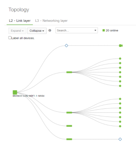

Look at the image below. It shows a layer 2 network topology diagram inside the Meraki Dashboard. Which sentence is true regarding the topology?

The correct answer is c! The network topology on the Meraki Dashboard supports both Meraki and non-Meraki devices. Options d an e were correct statements about the Layer 3 topology, not the Layer 2.
C.
C - shows Non Meraki eqpt if one hop away. Represented by an empty diamond.
C is correct and diamond may also denote Meraki device(s) that are on a different Org/Network
Correct Ans is A
It can be downloaded in JPEG format
Ques is asked aboout topology
Trick question maybe as yes if you took a Windows or Mac Screenshot then you can store that as JPEG.
BUT if you Navigate in Meraki Dashboard to Network-wide--->Monitor--->Topology the Download option only saves in SVG format graphics file.
So still think C is the correct answer.
