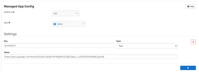

Both profiles with the same tag, one profile with the Single Mode Setting, and the second profile with the Manage App Config & Web Content Filter setting.
For simple testing purposes, I'm only limiting Safari to allow access to www.yahoo.com
and this is what I have set up in the 2nd profile...
Managed App Config
Web Content Filter
What am I doing wrong?

Your settings will only allow yahoo page specifically.
For the example I talked about, we had to supply a bunch of different pages that were all part of making a survey function correctly.
For example, it had the survey address, then the address and /index.html, then the address and /young-person/sign-in/ etc in the web content filter.
The managed app config supplies the initial main page link. The web content filter 'allows' only those extra addresses needed to make the page work.
I suspect it would be worth you testing the google form and seeing what addresses it uses when you're filling out content on it. That should give you all the addresses you need to be able to put in the web content filter section, which should then allow it to work.

Hi again,
Yea, I do have Managed App Config with Safari.
Managed app config is undocumented and I'm surprised that it's still working. This could be the reason that you are having mixed results. If you've found how to configure safari on apple.com please provide the link.
Right now, seems to me the iOS has to be iOS15 or higher for it to work.
And right now, iPad 8th gen is the easiest. Where I only "Whitelisted" the URL to my Google Form Prefill link and nothing else.
But on iPad Air 3rd gen with iOS 16 or 17.1, I have to have doc.google.com whitelisted as well.
iPad Air 2 with iOS 15.8 with ONLY Whitelist of the URL of Google Form.
it makes zero sense to me.
