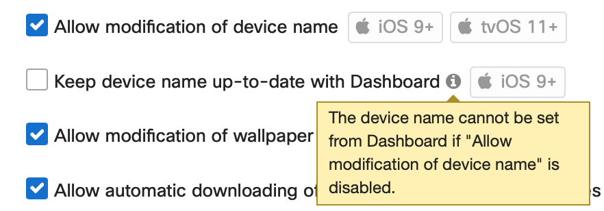

But according to this info, I would need to allow modification, set the name through dashboard and disallow modification again.
Or do you guys have a workflow to share? We would like to set device names to users username automatically 🙂 and they shouldn't be able to modify it.
vassallon
Head in the Cloud
@beks88
With iOS 13, Apple has created a way to update the name with the Allow modification of device name restriction in place.
I passed along this information to @Noah_Salzman but as far as I know it has not been implemented yet. Hopefully soon.....
So yes, the workflow we have to use for now, is to allow modification, set the name through dashboard, get the iPad to check into Meraki, update the name and disallow modification again.
