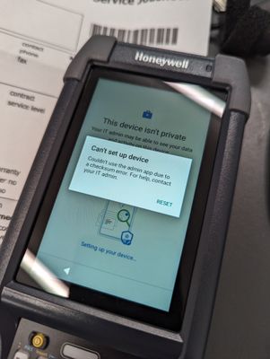

We have some Honeywell handheld devices. 5/8 have enrolled successfully. However, 3 are all getting the same error.
"Can't set up device  - Couldn't use the admin app due to a checksum error. For help, contact your IT admin"
We're enroling them as admins into the Meraki MDM Systems Manager.
Any actual help or step-by-step fix would be appreciated.

    • A screenshot of the error would be handy

Hi Connor,
  • Honeywell CK65
  • Android 11
  • Current device count: 5. License limit: 8
  • Device owner.
Enrolling via a QR code post factory rest after tapping the screen six times etc.
As I mentioned, the first 5 have been perfect and picked up all of the settings, just the last 3 all getting the exact same error.
