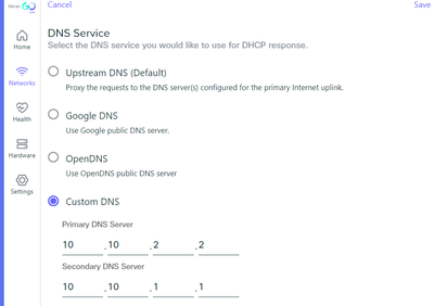

The thing with DNS. Every device, that is capable of connecting to the internet has DNS build in and can act as a DNS server.
From my understanding: Meraki Go's DNS server is picked by the GX-device when you activate a security license. Since it is DNS based blocking.
If you set the connection type to DHCP on the WAN-port, the GX-device will pick the DNS servers of your ISP. If you set it to Static IP, you can enter any DNS server you want.
For LAN, the GX device will allow you to set a specific DNS server to be used by devices connecting to any VLAN.
If you choose Upstream DNS it will be the IP of the GX-device that will be forwarded to the clients on the VLAN. So the GX will act as server, the GX will ask the server specified in the WAN settings, if it isn't able to answer the request by itself.
I use Custom DNS.
The IP 10.10.2.2 points to my private DNS-server. While every DNS server on the world points to my public IP when I want to access my own site. I needed a DNS that will point to a local IP, when I want to access my site from my LAN. I have one public IP and loopback doesn't work. Hairpinning isn't available on the GX so it was the only way to make it work.
The Secondary DNS Server is my GX.
A valid IP address is xxx.xxx.xxx.xxx (the x stands for a number).
If you don't believe, what I said about every device can be a DNS server is true. On a Windows PC you have a file called hosts. That's kinda the way to tell your computer A-records of websites. The hosts-file is always the first thing, a Windows PC tries to find a DNS record in. If nothing can be found there, it will ask the next known DNS server.
If you want to block google.com on your Windows PC, all you have to do, is adding this line to the hosts-file: google.com 127.00.1
GC1
Hi Xydocq - thanks for all the information. I'm glad you sent a screen shot, as my UI on both the iPhone and browser don't match what you have. Selecting a DNS Provider is a popup - not the selections that you have.gx50.jpg Not sure why your GX50 would have a different interface than mine - I have the latest version of the app installed on my iPhone. Frustrating.
