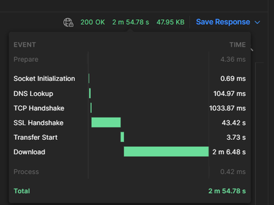

Well the more people that raise tickets the better I guess. Slow responses are annoying, incomplete/truncated responses (invalid json) are something else. An example below took nearly 3 mins and sent ~48k of the 160k expected. The SSL handshake was very long and unusual in that request, most of the time it appears to be the download. It's definitely a lot slower during 8am-9pm timeframe, early this morning a call was still slow 5 seconds, but as the day progresses it has become more erratic and flaky.
