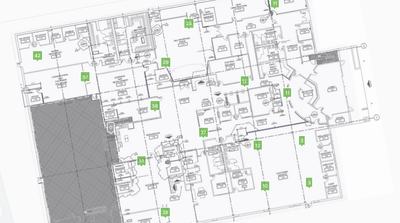

Users are starting to complain.  newly occupied building, getting lots of these failures:
auth_mode='wpa3-802.1x' 11k='1' 11v='1' error_code='17' radio='1' vap='2' channel='157' rssi='24'
auth_mode='wpa3-802.1x' 11k='1' 11v='1' reassoc='1' error_code='30' radio='0' vap='2' channel='11' rssi='61'
all windows clients, plenty of APs, so why error code 17 (Association denied because AP unable to handle additional associated stations)
