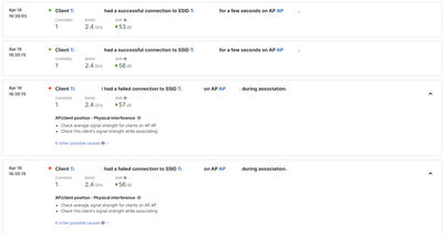

Hello all,
We have a user on the network that is unable to connect to WiFi.
When testing on external networks, it connects normally.
I checked the events and found the client fails many times during association, but then I have some events that he successfully connected for a few seconds.
Does someone has any suggestions to troubleshoot this issue related to error code 43?
Thank you in advance.
2 Replies 2
Do you have 802.11r and 802.11w enable? If yes try disabling it.
Yep, it looks like the device might be brain-dead and not support 802.11v.  You could try seeing if that device has any firmware updates first.
