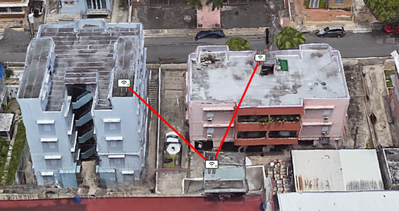

Presently the Ubiquiti AP's are connected to the blue building, the idea is to connect both building as shown.
You know you won't be able to use Mesh between Ubiquity and Meraki right?
I would personally go with the MR86.
