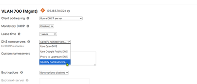

Is the MX your DHCP and DNS server or is it something else?
How can the DNS be updated if you have statics? the DNS is handed out as option 6 of the DHCP accept... If it is the MX remove the proxy to upstream and designate the servers by IP here. if its not the MX set your MX to ignore DHCP traffic on the AP mgmt.

Our MX is our DHCP and it is set to use Google from that drop down list. On the AP, I have set a static IP but it want to keep using the DHCP address. Normal network configuration disables DHCP if you use a static IP. Is this different for these APs? So in order to have the APs use the defined static IPs I need to disable the DHCP service on the MX? I read that Meshing needs to have DHCP enabled so I have since disabled Meshing and they are still using DHCP.
Out of 38 APs, we have an average of 2 or 3 APs at any given time disconnected and saying Misconfiguration of DNS. Then we have about 5 or so APs that never have this issue. All are on the same subnet/vlan and all have the same IP settings, static and using manual DNS servers for Cloudflare 1.1.1.1 and 1.0.0.1. Originally they used the Google option in the DNS dropdown. I didn't cable tests on all the AP connection and they all came back as OK.
