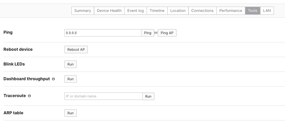

I would suggest using the tools tab under the AP's settings to ping Googles DNS and see if you get a response.
eroche
Building a reputation
So yeah we are getting dropped packets on the couple I tested even with the Cloudflare DNS configured. These are all new cables runs, 38 total. What I am seeing as well is even though I have static LAN IPs on the APs the Summary tab shows it as DHCP and the DNS isn't updated.
