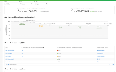

See photo of wireless health
DHCP and DNS is done by routers on different vlans. All traffic is allowed on trunk ports on our Cisco switches. It seems to be most problematic on the SBC-Occupier SSID mainly.
