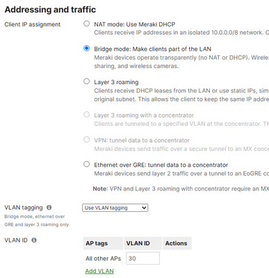

SSID is set to the below?:

The LAN firewall rule is set to allow. And yes the the SSID is configured just like that.

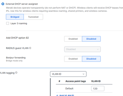

Verify the access control:

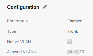

Verify MR´s Port:
