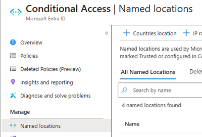

Typically, if you wanted to restrict which devices have access to an application in an Entra ID world, you would use a Conditional Access policy.
You can configure a "Named Location" and mark it as trusted.

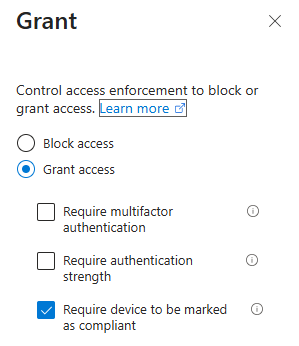

In the "Grant" section you can also require that a device is required to be compliant:

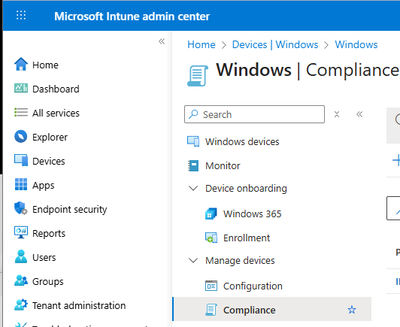

And then you can create an Intune compliance policy to define what you mean by that.
It is quite a lot of hassle if you don't have Entra ID conditional access in use, combined with Intune and compliance policies.
