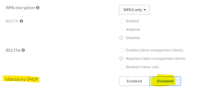

Under Wireless/Access Control, have you got Mandatory DHCP disabled?

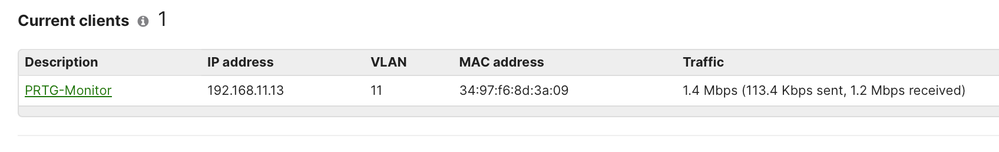

Have you checked VLAN settings for both ports?  Can the MS see the biometric device attached to the port? It should be listed under the Current Clients information.
Bears
Thanks for reply.
Biometric has static IP and is connected to WiFi
PC is connected over wired (DHCP client) to switch
Only the biometric is visible in Current clients table.
Bears
You nailed it! Wow! It is now responding to the ping.
What's the effect basically in disabling this?
Enabled: Wireless clients associated to an AP (either new associations or clients that roamed from another AP) that have not requested a DHCP address are placed in a blocked state and are not able to send any traffic on LAN and WAN.
