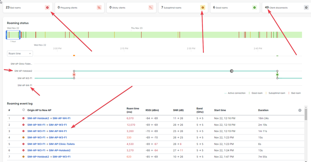

So after 5 years or so of our full stack Meraki implementation complaints in a particular area of our building are ever more increasing.  We have users who are sat working happily on 5 bars of signal strength connected to their local AP and then for no apparent reason they will then Roam over to an AP on the floor above or one at the other end of the building and the speed/connection will be so bad they'll either have 1 bar shown or it will show the globe icon "no internet".

See below a user that is having massive issues and is more or less sat in between 2 AP's (W4 & W3)

Is it for all users/SSIDs on these APs? I see those APs have 6 SSIDs in use. Or, are only certain devices or certain SSIDs problematic and if so which ones?
Also, those APs use a RF profile in which the 5GHz band is set for max tx power of 10 dBm and a min bitrate of 24 Mbps. That's going to create really small RF cells. In a super high density environment that might be acceptable. But it's not a config I would expect to see in most routine office deployments.
All of the RSSIs in your screenshot aren't great which leads me to believe the clients are either pretty far from the APs or due to your RF profile 5GHz setting and the really small RF cells those are the best they get. Wireless clients are what make the decision to roam and if the clients sees all the APs at low & similar RSSIs it could lead to the client attempting to roam more often in search of a better signal.
You might also want to disable Client balancing on the RF profiles as see if performance changes.

Thankyou Ryan,  these were the kind of pointers I was looking for.
You've actually made me think that maybe I have focussed too much on roaming when actually the issues stem from people who are sat in office and conference rooms. They are the ones are having the issue because they are starting on a great signal and bandwidth -  then for no real, quantifiable reason flipping to a weaker AP further away and subsequently ruining a Zoom/teams call in the process.
Maybe I need to remove the client balancing as we're never likely to get much more that 40 people on 1 AP ever.  I think I should have enough for dual/overlapping AP coverage in every placement.
I just find it odd that I can be sat right underneath an AP yet sometimes my client will still connect to or pick up and inferior AP.
May I add that my IPhone works perfectly anywhere in the building with max strength everywhere, all the time it's just Windows laptops and Andorid phones that the issue is with mostly!
