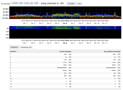

I have 12AP each transmitting 3 of 4 SSID in a factory in Slovakia that's basically a part of a huge warehouse, our bit is split into four chunks by fire proof walls. There's some offices too at each end. So, anyhoo, it doesn't seem to matter what I do, one of the AP shows "Jammed" on 3.4GHz, and almost all others show very high useage. It causing me problems of very high latency which is bearable for the limited web-app traffic from that area, but causes problems for the half dozen wireless IP cameras I have running
My neighbours on either side run wifi which i can detect at sometimes very high levels, and the landlord has recently ringed the entire site with outdoor AP providing voice and data links as a service to other tennants. In the screengrabs below "DSN" SSID are mine
I am using auto channel selection, and the profile I am using is based on the "Open Office" template. AP are about 20m apart. What's puzzling me is why the AP is still using CH6 if CH6 is so badly congested? Why doesn't it switch? I am no expert in WiFi, my network knowledge is "enough to stop things breaking" usually, but I am all we have

Do you know what might be causing the interference? Microwave, radios, handheld phones (2.4ghz), etc? You would also be able to change your channels manually away from channel 6 if it's congested through your "Radio Settings" and see if it improves. Since I don't know what's in the warehouse I cannot give you more info but I hope this helps.

Having lived in Mitteleuropa, I would suggest that you don't fight for space on the 2.4 GHz portion of the spectrum and go up to 5 GHz.
There is a lot of kit around that is at best shiite, and under certain circumstances, distinctly unfriendly. All the door bells, weird wireless phone extensions, wireless speakers, selfish neighbours with super-performant Access Points, dodgy RFID readers, noisy neon, refrigerator motors, lathes and other machine tools, anti-drone systems, to say nothing of electric jugs, old neon signs, faulty switchboards. All of these, and more, stuff up the 2.4 GHz band. With a limited number of non-overlapping channels you will be playing wack-a-mole.
If close to the airport, the Danube, military bases etc, be careful to avoid interference emanating from these sources.

It's the "selfish neighbours with super-performant Access Points" that are causing my issues i think. I am moving everyone i can up onto 5GHz. I am about 50km from Bratislava so far enough from airport etc, but a lot of industrial neighbours. As is common here the estate is made up of huge logisitics sheds about 100m wide, 800m long around 25m apart, and we have a 400m chunk in the middle of one of them.
