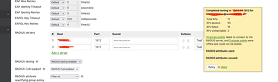

Hi, does anybody know what to fill in in the RADIUS-test (Username / Password)?
Is it an Cisco ISE (RADIUS-server) account? (didn´t work).
Is it an Active Directory account? (didn´t work).
My RADIUS-server Cisco ISE is working well, everything does as it should be.
But I want to know how this test is working.
thanks

This is not working. This error message appeared: Authentication failed while testing on one of your APs. This means the RADIUS server was reached but your credentials were incorrect. The test was stopped to prevent this account from being locked out due to multiple failed attempts. Please try again with different username and/or password.
I think it´s not a domain-account.
