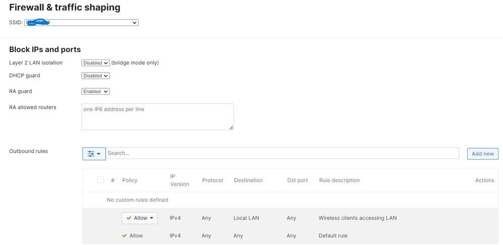

Hi there,
Many thanks for your reply. I can see L2Lan isolation is not enabled (Which is correct?) and no deny rule in place. Any other suggestions much appreciated
Could you please share the SSID configuration with us?

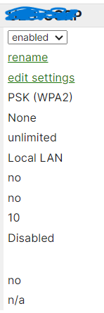

PJB
Still having the issue. Also from the dashboard I can ping the printer from all other SSID's Vlans I set up, which I dont want, especially the test guest SSID. I have attached all relevant information. Hope you can shed some light on this.FW & Traffic Shaping SSID.PNGSSID info 2.PNGSSID info 1.PNG
