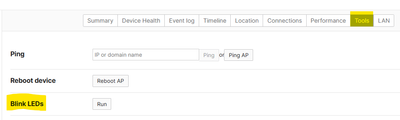

Do you by chance have any APs in your inventory that are not in a network (because all of the APs were claimed at the same time)?
If so, try adding them all to a dummy network, wait 30 minutes, and see if any of them light up.
If a couple come online, use the "Blink LEDS" feature to narrow down which one it is.
