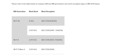

Mesh Encryption Improvements
MR 29.1 firmware supports robust WPA3 equivalent encryption with SHA256 key for data packets between the mesh peers in 2.4/5/6GHz bands, while previous MR firmware versions (MR 27.X MR 28.X) support AES-CCM (SHA1) for mesh encryption.

Mesh is secured via AES.  This has nothing to do with you client serving SSIDs. The mesh entropy depends on model of AP and FW revision, see within the same document further down:
