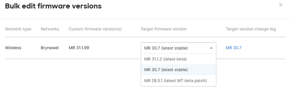

@AYEN if the upgrade was auto scheduled a couple of weeks ago then it would have upgraded to 30.6 as that was the latest stable at the time.  If the upgrade was done manually then the person selects which version to go to.  Below are the versions currently available on one of my networks:

A little while after each time a new stable version (or other if the network is configured to try betas) is released, it will be pushed out and you can then decline or reschedule.  You can also get Meraki support to lock the AP to the version requested.  However, why are you trying to do this?
