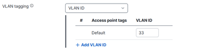

CameronR
I believe so I reviewed the template used and seen it was set to a single VLAN and on 1 default.
I added both of my VLANs and tagged guest to the appropriate VLAN ID. Validating the change now.

CameronR
I've configured the VLANs and  DHCP to relay to the Cisco 9300 providing DHCP for the guest network. I've also configured a vlan for our corporate network but haven't applied vlan tagging as it's caused issues in the past. Validating now.
