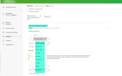

Go to the SSID..... Under advanced RADIUS settings
Look at the field below the one i highlighted labeled NAS ID

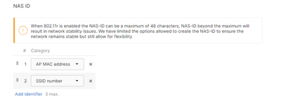

Seems that it is now supported ( don't know since when ) :
That doc page needs a refresh.
