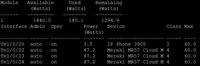

however, are they poe+ or UPOE 3850's are the AP's showing they are pulling the full 30 watts? -> Yeap, in fact they are pulling 47.2W for each APs.

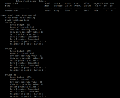

I would also see if you can pull any events from the switch(s). -> Below are the logs on the related to the corresponding port.

"47.2W for each APs." 40Watts is the Maximum for the MR57. Did you mean 47.2 Volts?
https://documentation.meraki.com/MR/MR_Overview_and_Specifications/MR57_Datasheet#Specifications
Judging from that Screenshot; perhaps Spanning Tree could be shutting ports??? That would make sense if configured in 'Power Sharing' mode'.
As y
ou have an Agg/Port Channel configured. Make sure it is configured correctly and matching on both the switch and MR57. See below details.
https://documentation.meraki.com/MR/MR_Overview_and_Specifications/MR57_Dual_Uplink_High_Availabilit...

Nope, it's 47.2W. Please find the sample output below. Is this normal? I mean, the AP is overconsuming above than the stated wattage on the device manual?
I do not think spanning tree is shutting ports, since the port is not disabled. Only the device is going down the up again. I have checked, my switch is configured in power sharing.
I only connect 1 LAN into the MR57 AP. So I do not have aggregation towards the AP in my deployment.
