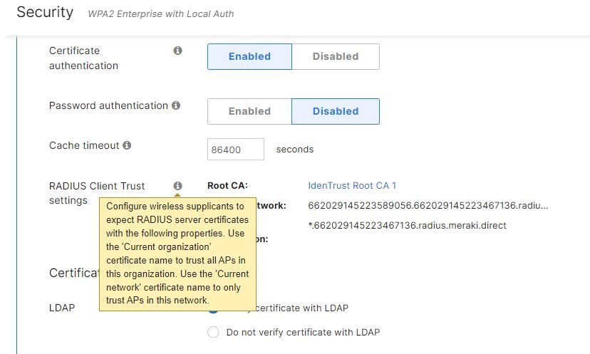

Bdcvc
Hi, we just resolved this issue.
Solution : Install the IdenTrust Root CA 1 certificate on your end devices.
Please refer to : : https://documentation.meraki.com/MR/Encryption_and_Authentication/Meraki_Local_Authentication_-_MR_8...
