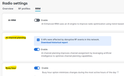

While you are there, make sure you have enabled AI channel planning.

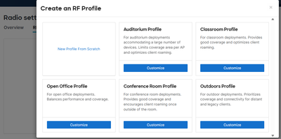

Don't use the "Basic Indoor Profile" - that is the one with the default settings, primarily designed for customers with a single AP.
Use the option to create a new profile and choose the option that best describes your environment.
