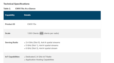

Sorry, the AP we purchased was the CW9176I.
The specifications state that each radio can handle 400 devices (1,200 devices total for 3 radios).
How many wireless terminals can be connected to this AP per unit?
(The specifications state 400 units.)

Sorry. The AP we purchased was the CW9176I.
Is it unreasonable to connect 200 wireless terminals to the CW9176I?
How many wireless terminals can be connected to each AP?
I'm a beginner. Sorry.

The datasheet I checked makes no mention of 400 clients.
https://documentation.meraki.com/MR/MR_Overview_and_Specifications/CW9176I_%2F%2F_CW9176D1_Datasheet
https://www.cisco.com/c/en/us/td/docs/wireless/access_point/technical-reference/cw9176-dg.html
