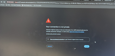

As of now, some of my users is not able to connect with wireless connection from the captive portal. I have done some packet capture during the authenticatiom until the unsecure connection to http:<server id>.network-auth.com/splash has been stucked.
The status code is 302 which should be redirected with our custom URL for splash page.
Weird thing is if I will copy the redirected url of meraki it will able to redirect to my custom splash page bht if it from the authentication from msftconnectest.com> network-auth.com it stuck with unsecure connection.

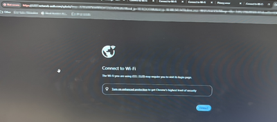

My work around as of now is copy first the temp url given my meraki and copy it to browser with incognito mode and I am able to proceed with the custom splash page.

Can you send a screenshot of the error?

Below is the error prior splash page when I have received the error.
Per checking on the packet capture, temp URL has valid cert but when I check the process get process and response should be https. (Correct me if I'm wrong). Below is the link for documentation
