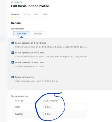

@PhilipDAth you have to change the profile from the default of dual 5GHz to 5+6.
Do you not see the below?

I don't get an option of "Fixed Radio Selection". I think I'll open a support case.
