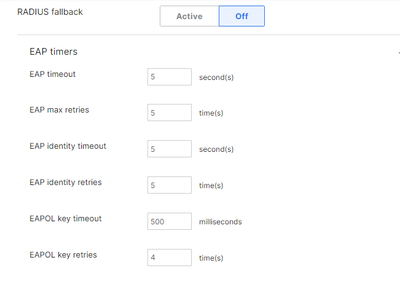

You can find EAP timers on advanced Radius settings, but it does not have a reauthentication timer.

I checked already, but no luck, so want to see any expert here know to configure the reauthentication timer or any default value of the reauthentication in Meraki.
Unfortunately, It's not possible buddy. This is I'm trying to say.
