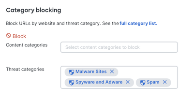

Pretty limited on the MX content filtering - just malware, spam, and spyware
