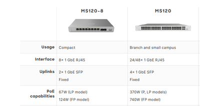

Good morning, to connect 6 MR44 Access Points without the need for PoE power, what MS Switch could you propose?
You need to calculate it. For example 740W divided 30W (PoE+) = 24

Yazmin2
¿Cuántos puertos máximos admite PoE+ en el Switch MS120-24P y MS120-8FP?

At least .af PoE
Note that although the MR44 will run on 802.3af (15.4W) the MR44 will retard its functionality.  To get all the capabilities you need 802.3at power.
