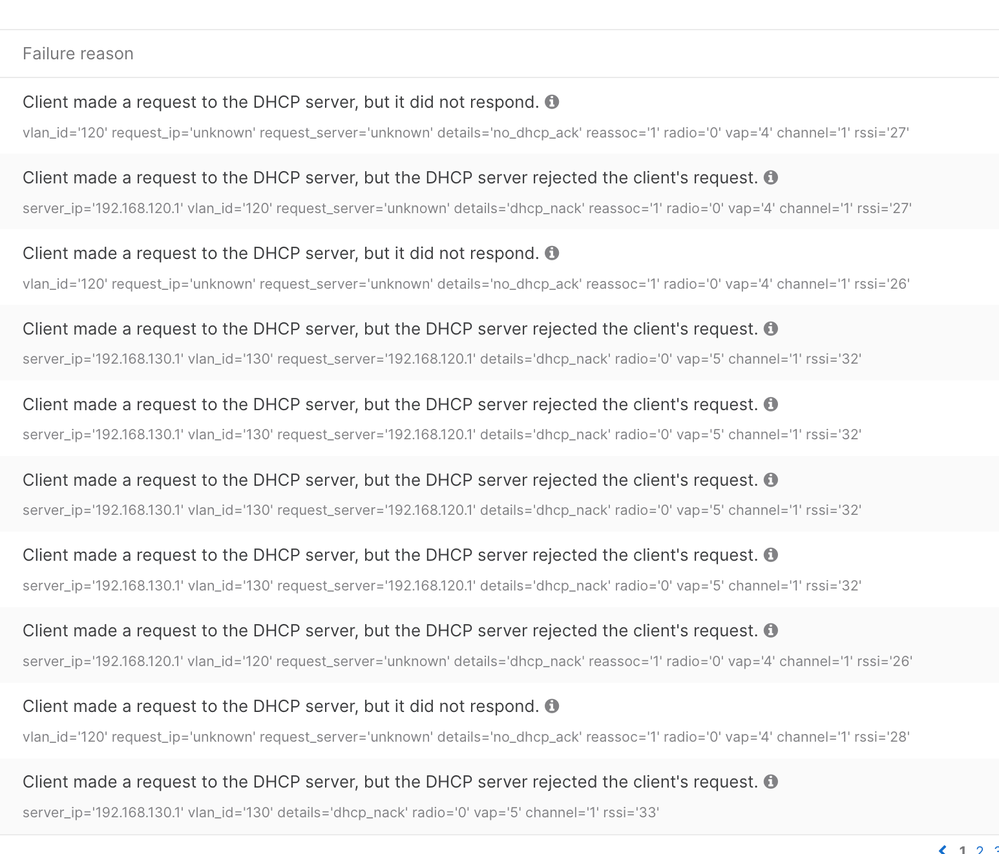

What does the MX event log say? Loock for DHCP events.
Perhaps the DHCP scope is full.

The DCHP scope isn't full. I created separate VLANs to rule that out.
Here is a screenshot of the errors for the past 30 minute.
