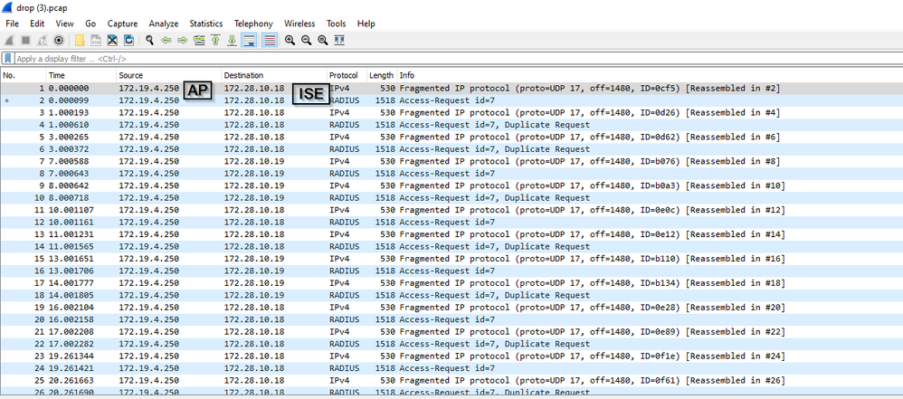

Hi All .
Sorry for the delayed answer . I have lowered  the MTU onto the switch the APs are connected to but that hasn't made  a difference .However, I just noticed that   that the APs Radius requests are experiencing some packet drops as they hit our Onprem firewall ( yes there s a firewall indeed ), 2022-12-19 11_25_34-drop (3).pcap.png  any idea why ?
The packet capture in attachment has been obtained from the firewall.
Thanks in advance for all you input

Just to let you know  the matter is now solved . Our on Prem Firewall had a Zone protection profile  with a setting instructing  the firewall to drop fragmented traffic .
Once  that setting was updated it worked .
