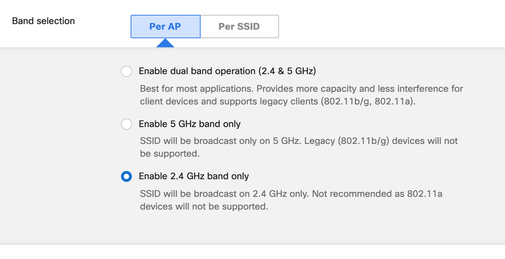

Under Wireless > Configure > Radio Settings > RF Profiles I can choose both or a just 5 or 2.4 GHz. This is under the Per AP selection:

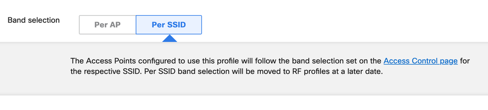

However I don't want my entire AP to be 2.4 GHz; just one of the SSIDs. However when I select that, there's no 5 vs 2.4 option:

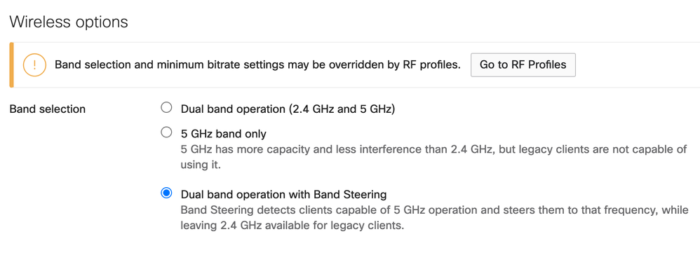

It says that it'll follow the band selection on the Access Control page. OK, so when visit that, the options are dual, 5 only, or "band steering":
But "band steering" isn't what I want! I want 2.4 only.
