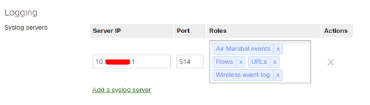

I am attempting to implement a SIEM connection and am following instructions in Cisco Meraki - Syslog Server Overview and Configuration.  When I add it I receive the following error: "Settings could not be saved. Please verify that your connection is working and try again."
This is only happening in one of my wireless networks... I have a standby network that does not have any devices and I was able to add the syslog to it.  I verified that I have full admin rights across all of my Meraki wireless networks and System Managers.  I have also verified syslog server, firewall, and SIEM configs are correct. I have tried in different browsers (Firefox, Chrome, Edge).

What port did you enter?
Can you try another ip+ port. For example ip 1.2.3.4 port 5555

@ww I have tried the recommended UDP port 514 (syslog), as well as 515, 989, 990, 5570 and 5540.

@FBettencourt I know this sounds really silly, but have you added the roles you want sent to the syslog server, as below:

@cmr - no worries, lol!  Yes I have.  I have tried one role as well as multiple or all four available roles.  It's weird because I was able to save the config change in another network, just not the one I need data from.
