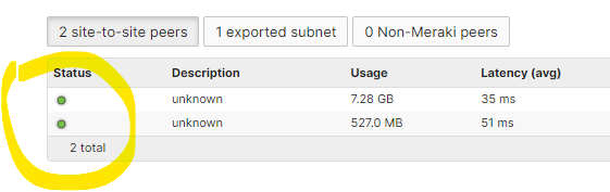

TalentBari
New here
this is another office with the configuration of the 2 tunnels not in error.
that's why i think the problem is in one tunnel
