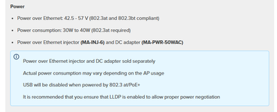

If the device is only receiving 30W, it may not be receiving enough power for optimal operation.
I suggest you open a support case.
CW9166 Installation Guide - Cisco Meraki

marce1000
        - Enable LLDP on the involved port(s) ,
