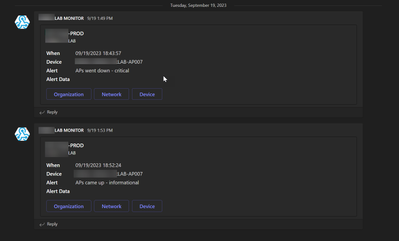

Yes.I get alerts now. Is there an option to get the name of the AP as well . The alert it shows just AP down. Is it possible to get the alerts with AP name?
TBHPTL
Head in the Cloud
Yes, with a webhook.
MDB natively supports many differing webhook formats. Slack, WebEx, MS Teams, Service Now..

Once its set up you simply enter the webhook into the default or specific notification field.

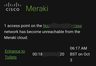

cmr
You should get the AP name like this in the body of the email:
