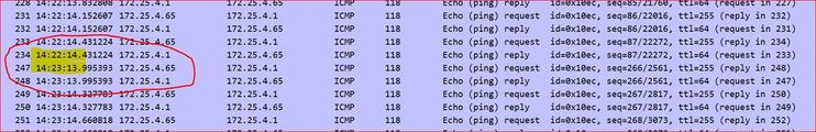

I've got packet captures from the air and on the LAN.  My tester is pinging the gateway.  As soon as the roam occurs the ICMP packets are not bridged to the LAN by the "roamed to" AP.  And there's no DHCP traffic either so Support seem to have got that one wrong.
No ICMP until it roams back to the original AP!
